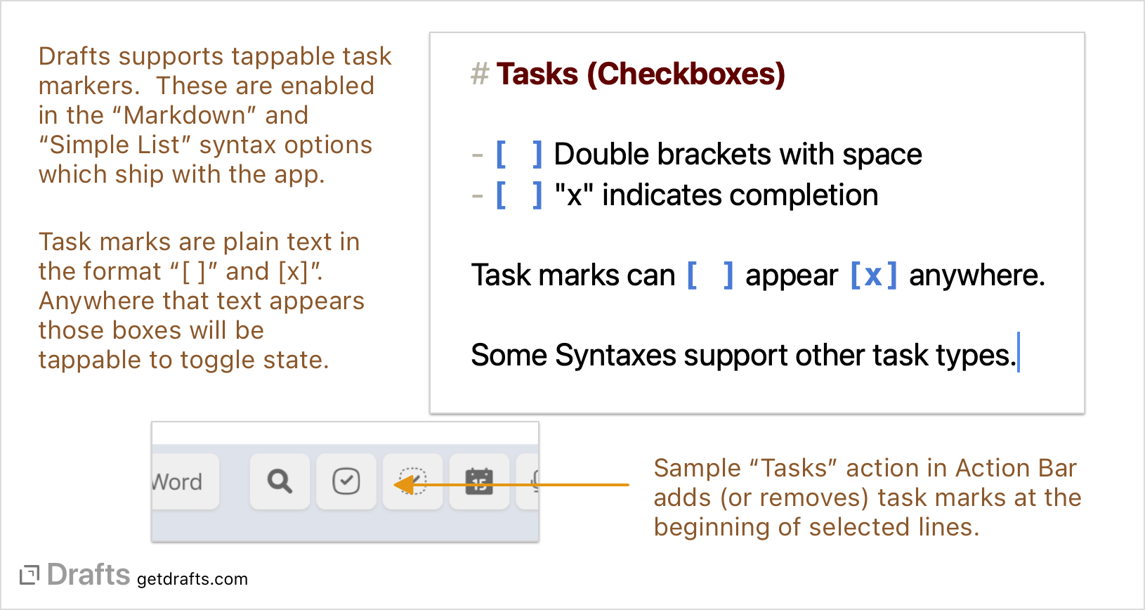

Although tasks are not part of the Markdown specification, Drafts supports the common practice of treating square brackets with a space between them [ ] as a task.
In the Markdown, MultiMarkdown, and GitHub Markdown syntaxes that ship with Drafts, simply type [ ] to get a task. That text becomes tap/clickable in the editor. [x] is considered a completed task.
If the [ ] appears at the beginning of a line, or a Markdown list item (e.g. line starting with * [ ] or - [ ]) the line will be parsed as a task, with the text of the line as the task name.
You can also place [ ] in other arbitrary locations in the text and they will be tappable, but will not be treated as a “task” because it’s not clear what text to associate.
By default, completed tasks are styled as dimmed, strikethrough text. These syntaxes all provide settings to control this behavior, which can be changed in Editor Settings.

Since they are plain text, tasks can be created by just typing them – but actions are also available to work with tasks.
A couple of common example actions:
  • Make Tasks: Makes the selected lines (or current line) into a task by adding - [ ] at the beginning. If the all the selected lines are already tasks, remove task prefixes from line.
  • Toggle Tasks: Toggles the status of and [ ] tasks in the selected text, marking them done or undone.
