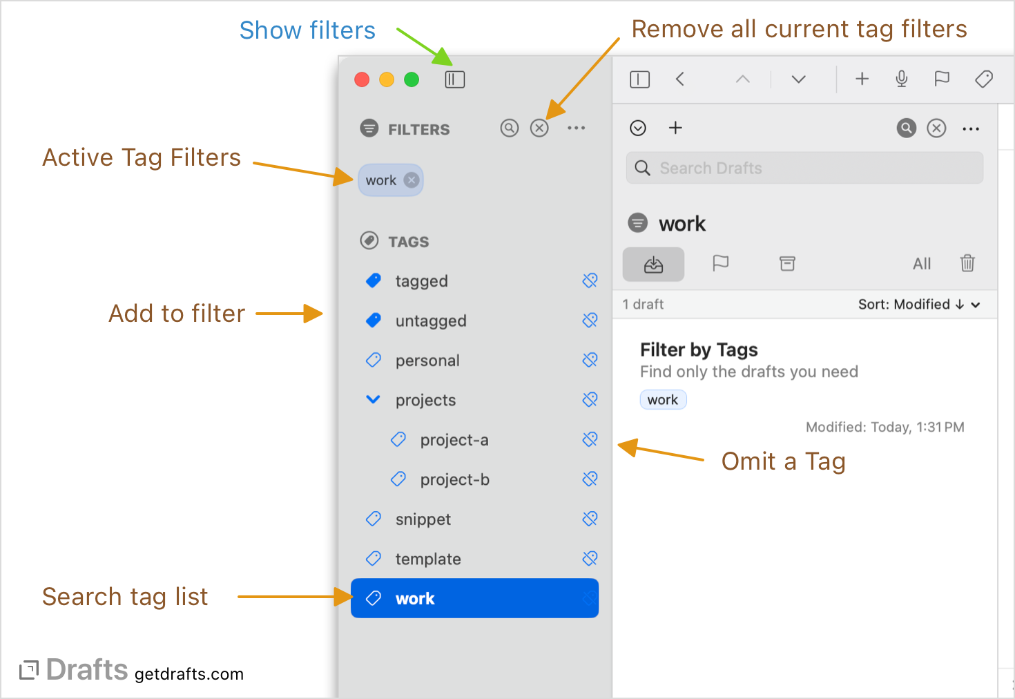

Tag Filters
iOS Mac
drafts/tag-filters
The tag filter panel allows filtering of visible drafts in the draft list based on tags. The tag filter panel appears to the left of the draft list. On iOS, tap the filter at the top or swipe to right on the list to display filters. On Mac, click the disclose toggle in the toolbar (or use View > Show filters in the main menu). Select one or more tags to filter to the list to show only drafts with those tags. In addition to tags assigned in your drafts, the following special filters are available:
  • untagged: show only drafts which do not have any tags assigned or only.
  • tagged: show only drafts which do have any tags assigned or only.
Filter Modes
The filter panel has two “modes” available, which can be toggled via the ... options button at the top of the panel:
  • Single Tag Mode: In the default single tag mode, only one tag can be selected at a time for filtering. This simplifies selection and is useful if you use tags more like folders for filtering.
  • Multiple Tag Mode: If enabled, filters can be constructed by selecting multiple tags, and even omitting drafts with certain tags from the results. Multi-tag mode also allows toggling between “any” (OR) and “all” (AND) queries to combine the tags selected in the results.
